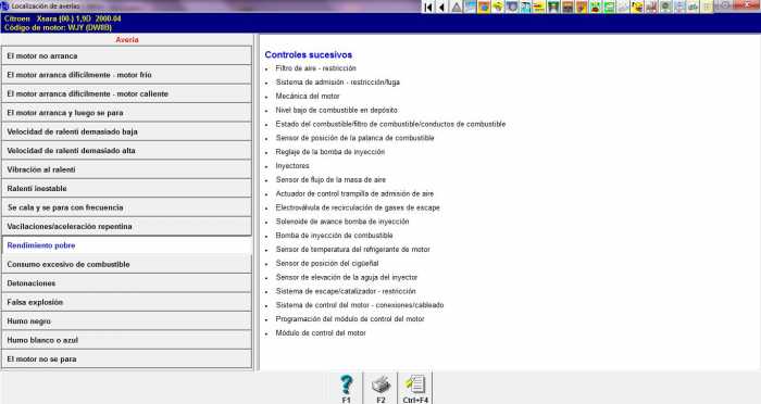

If I'm not mistaken, with the test light you'd take a positive wire, for example, from the battery, and go to the heater connector... If that's how you're doing it, you're checking the grounds.
The correct way to do it would be to put the lamp in series with the circuit so that it only receives positive power when the ECU sends it. I don't know how you would do it, but try it if you didn't do it as I told you and see what happens. If the glow plugs were always on, they would constantly heat the inside of the cylinder, making the air-fuel mixture hotter and therefore resulting in poorer combustion, since the hotter it is, the worse the combustion.
On the other hand, what exactly is your car doing? Low idle? Unstable idle? Poor performance? If you tell me more precisely, I'll check it in Autodata to see what might be wrong. What I've noticed here is that several common faults similar to yours recommend checking the air intake filter (maybe yours is wet and not letting air through properly) and also checking the fuel filter and lines. I'm sending you an image of the poor performance fault.
