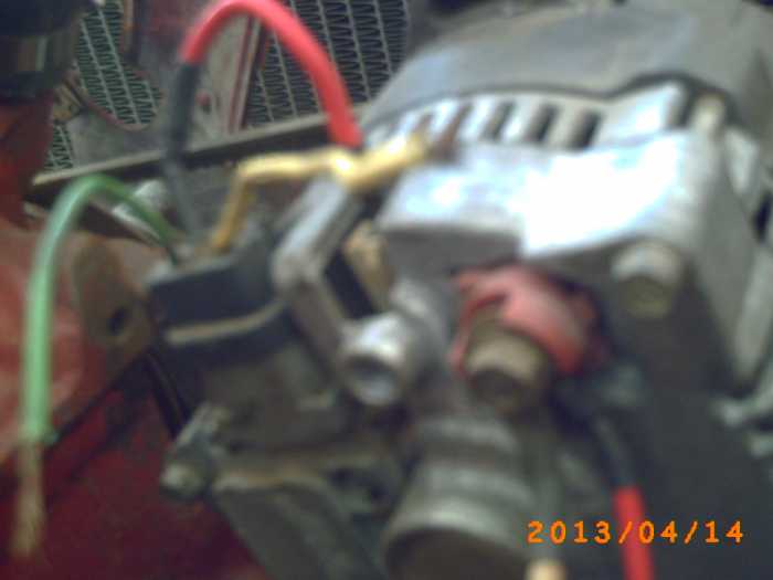

Good morning how can I adapt a motorcraft alternator with integrated three output regulator to a 282 Wagoneer 6 cylinders online from a throat thanks in advance and greetings to all
12 years 6 months before #41383 by manual-mecanica
Manual-Mecanica Response on the subject Adaptation
Everything can be adapted, you just have to appear in some things, that the alternator is online with the belt, if it is not the same tan you will have to make a piece to be able to put it, the electric part you have to check what is the pin that is fixed, signal and pilot light, then you make the installation according to the new alternator, but you identify it in the original box to not burn anything.
12 years 6 months before #41386 by manual-mecanica
I put the nomenclatures in case it helps in something, they are drawings that are usually recorded in the plastic housing to identify the connectors.
B + = Positive battery +30
D + = Chibato light Istruration Table
w = Taistarevolutions
L = Same as D +
+ or ing = +15 Starter key
B- = Negative
The alternator housing = is negative in European and Asian vehicles (be careful that in England and other countries it goes to the setlings).
You will not get all the symbols, with having 3 it already works.
