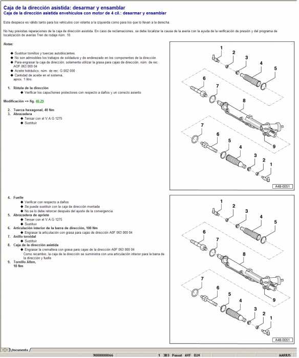

13 years 4 months before #35869 by manual-mecanica
Manual-Mecanica Response on the Re: Bomba direction fault?
Hello friends, because the bomb is not guilty, I just changed it and it has not improved anything, I have to look at the address box. I have looked at Elsawin, but there is no desire in detail, to see the valves it has.
