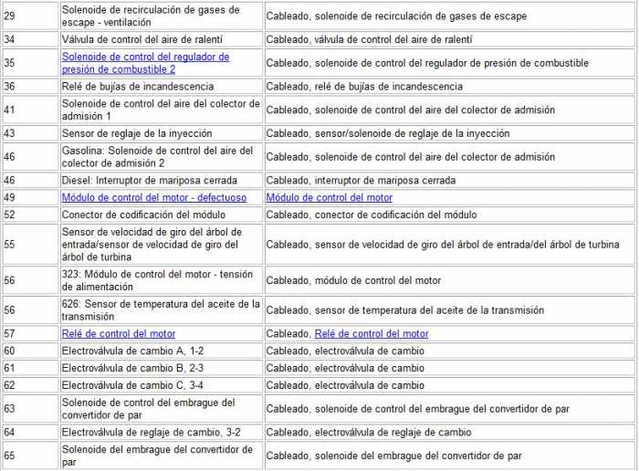

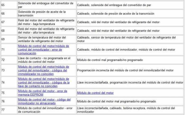

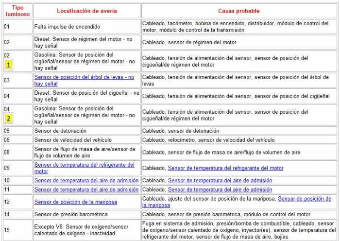

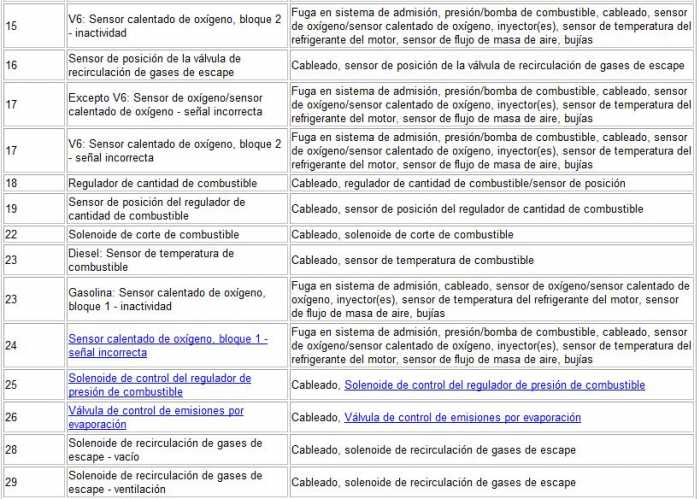

Manual-mechanics' response on the topic Re: ignition problem
Here is Compa, I hope it serves you.
