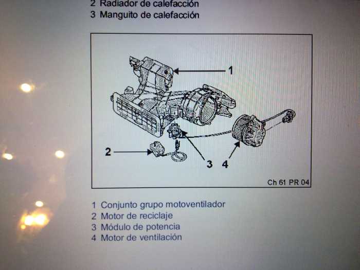

I have a position of the positions (1,2,3,4) of heating. 1,2 and 3 do not work for me, and 4 I do very well, the entire picture changed and remains the same, I do not know if the engine is bad or the power module. Can I help me algien?

Look in rality I do not understand your photo that you want to say with this but if you are talking about the speeds that 1,2,3 does not work and the 4 if it is resistance now if you talk about the gates as seen in the image that goes with the guales or the change selector if the heating there you do not use it can condemn that door also but in all way here I leave this help if it serves you

Hello, thank you very much for the answer but the problem is already solved. At the end it was the power module, I had burned cables.
