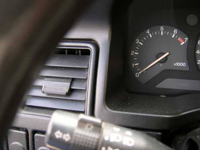

Total that when I get to a Semaforo, once a km traveled. Approximately the revolutions are lowered (as always) but this time it is covered ... : Blink: : Blink: After hallucinating because I had not happened for years, I started it again and, suddenly, the telling me for this:
Eye!!! With the engine worked eh ??? Accelerate to see if it goes up and nothing ... as if the plug had been removed. To all this, the engine began to sound as if it had stayed in three cylinders ...
Be careful, I turned to the shoulder ... I turn off motor, start and idem from the same ... Suddenly, the bulb was lit, and I explain:

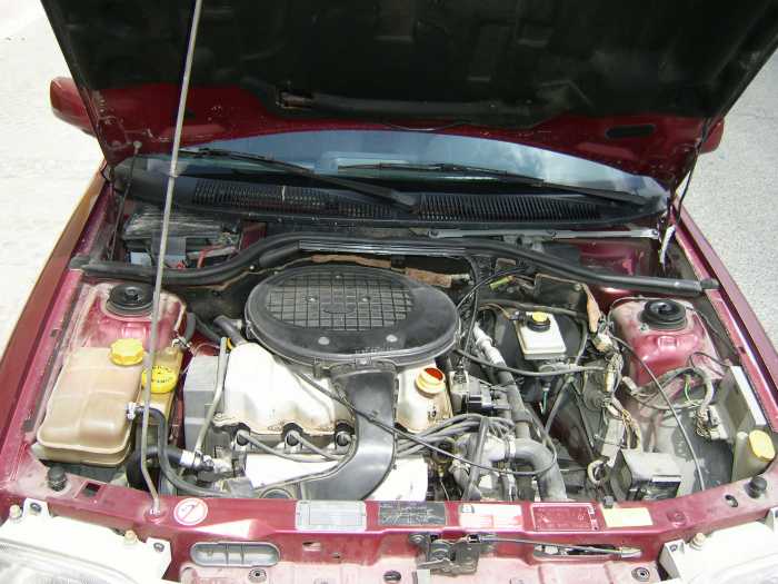

Well, this is my engine ...
And in this area is the connector that triggered ...

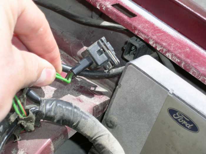

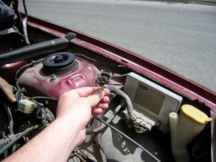

Standing in the shoulder, it occurred to me to open the hood and disconnect that plug again. I start the engine and voila !!! : Woohoo: : Woohoo: : Woohoo: I have a rise again ... the engine is no longer going to three cylinders ... follow the very low slowdown ... about 500 rpm. More or less ... but at least it seems that the car can drive. In short, I have bichea the engine and I have taken pictures ... this is what I have discovered ...

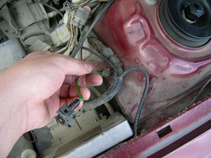

Here you have two images of the damn connector ...

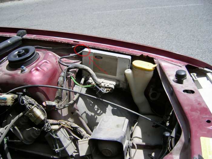

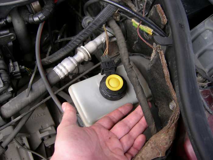

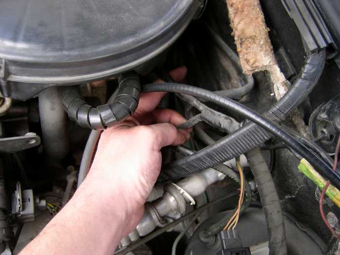

It is part of a cable hose and I have followed its route ... passes here ...

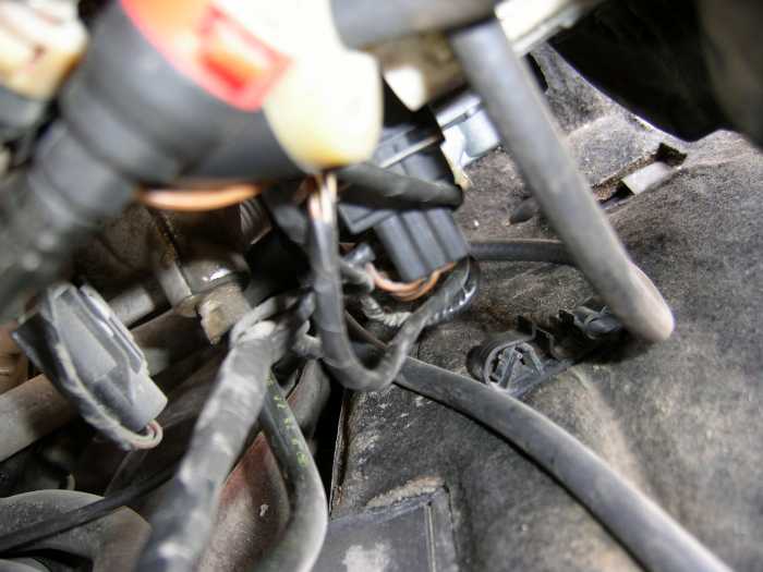

And when it reaches this area it bifurca ...
It seems that it is connected to one of the carburetor connectors ... if I'm not wrong ... to TPS ...

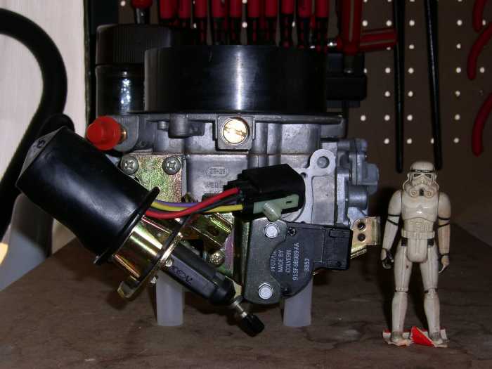

Finally, the only thing I have left to do ... I received this carburetor from England two days ago ...
[Attachment: 11] A.JPG [/Attachment]
The imperial assault soldier is coña ... is that one is a geek ... Anyway, I hope you can help me ... a hug to all.
