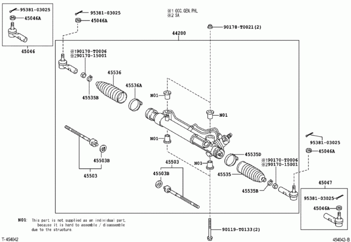

Friends, if I divide the number of turns by 2, the problem is that the terminal's threads don't allow me to continue aligning the car. I've already done this, but the terminal doesn't allow me to complete the alignment. It runs out (Ref 45503 diagram attached).
the speed bumps they mention, where can I locate them?
The prismatic arms are what they call internal terminals; it is the bar that connects the ball joint of the internal terminal with the wheel terminal; if this is the one, it is a package.

Hi, if that Hilux is from the Kun series, the stop is internal to the rack and pinion, and that's what controls the steering center. But if that Hilux is from the LN series, it does have stops on each side of the wheels, behind each wheel hub at the front, but that doesn't control the steering turning more to one side than the other. That's controlled by the steering system, and the problem is with the ball bearings being centered. Check this, and if not, we'll see what to do. Good luck.

Hi. What's the name of the catalog where you got the diagram you posted in this forum thread? I'd like to have it. Do you know where I can download it?
