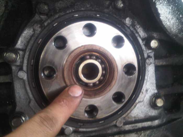

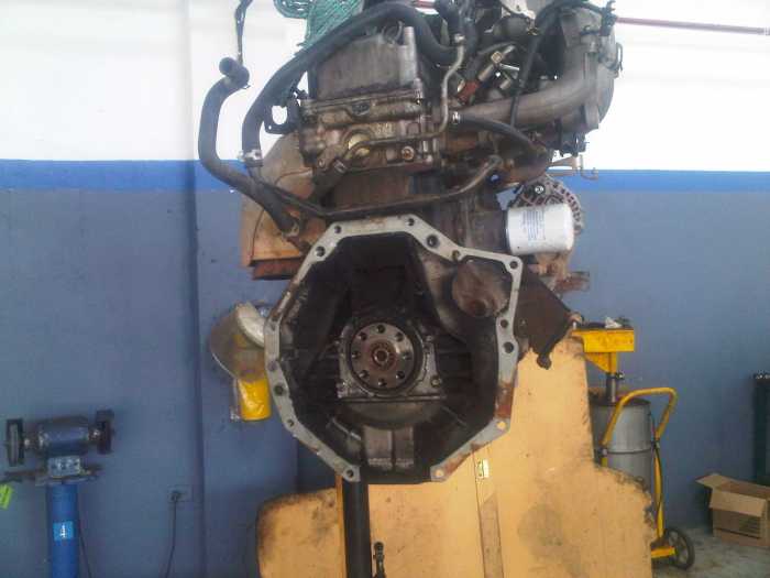

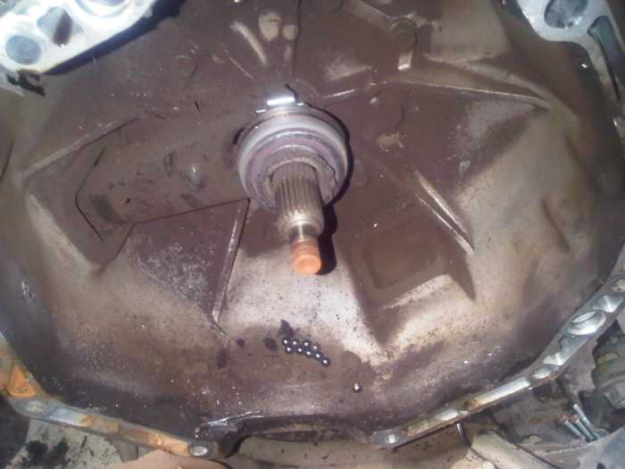

Good afternoon, I have a problem with a Mazda B2600 vehicle, which entered crane because the engine had stopped, go to verify the engine and effectively do not rotate, it proceeds to disassemble it and I realize that the balinera, the press and the disk are burned, but additional to this it also has damaged the balinera that goes in the crankshaft.
Well, I told you what happened to me, now I tell you the question I have; the balinera that comes in the crankshaft can be replaced, or does it come with all the crankshaft?
Please help me is a dilemma that I have but I don't want to disassemble parts that are not necessary ...

It is completely replaceable, one of the super practical methods to disassemble this bearing, through the hole of its central bucket to attack wet paper and with a piece that adjusts in its inner diameter hit with a hammer firmly in the paper taco and Vober ​​has attack more wet paper and repeat the operation until it gives the bearing. If they don't believe me, I will try to me !!! Holy Remedy ...

That's right, it is replaceable, I know him as a pilot

There is nothing better than the original, as is a piece of wear if they should sell it.
Or if you do not find it as the clutch kit you see there comes included.
I tell you this because here the clutch kit comes with the clutch, the oppressor dish, pilot bushing and the collarin
