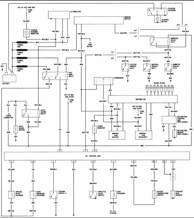

Someone will have the Datsun Nissan 1984 manual, Z24 engine, 720 ... I have been looking for it but I can't find anything ... I need to know what is the admission coil and what is the escape ... the electrical diagram of the Chazis ... I have a problem in the wiring and it could not be solved ...

Hello what happens is that I am looking for a manual to my boyfriend has a nissan z24, the problem it has is in the wiring that goes to the coils, it is poorly connected or something I think .. So what you are looking for is a manual or a diagram of how the XK coils should be connected to the XK coil TEACHES VERDD .. well and I am from metiche .. in itself is the problem that has .. the wiring of the coils and what is the escape and admission, and of the empty too ... how they must go so that each one is for and where they go and others ... I hope you can help me because I have already looking for a week and we really do not find anything ...: D jiji .. Thank you very much ..

Hahaha, now but I explain a little there are no coils for escape and admission coil, there are valvlas and, last admission and escape, now the year of Z 24 is important to determine some things, you have to take into account that there are few models that use two coils usually is one, or you talk about the order of the ignition cable The vehicle to urgar in the files of yesteryear, anyway if it is with distributor or carbure

Hello, let's go, I don't think you are a slender metiche that you help at a good boyfriend, oh, leave you a Z24 diagram of 84 I hope it will serve you
