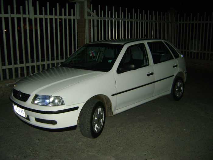

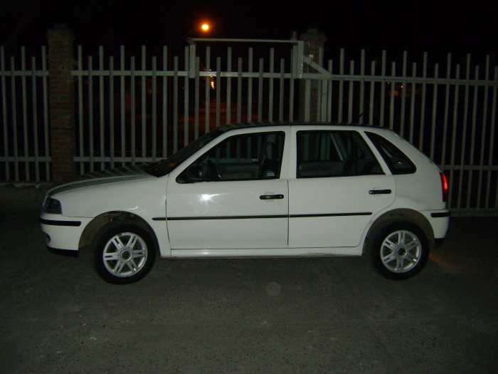

Hi
Kikemec and thanks for your answer I now upload the photo of my jewel .. accelerates to the partil then when walking and you stop when folding or in a traffic light begins to accelerate between 1000 to 2000 revolutions
