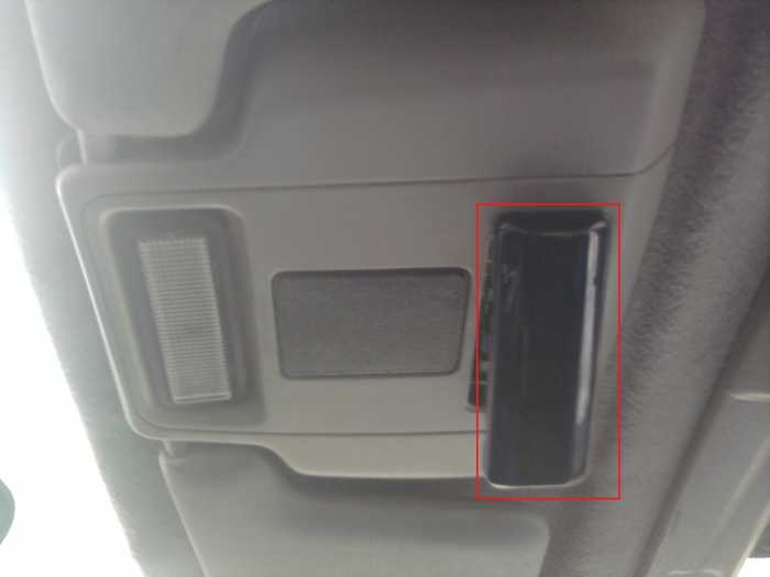

Hello friends, someone knows what this electrical system is in a Peugeot 405 year 1995 that goes on the roof, it is not for light or has to do with Sunroof.

Hi wal7er, that's the control unit that receives the key signal. It uses infrared to receive the signal and unlock the doors. This system is also used in the first-generation Renault Megane 1 and some Kangoo models. I have a 405, and in my case, I have a remote key, but it doesn't emit a signal.

Thank you Enzogennaro for confirming my suspicion, this Peugeot has made me crazy, the battery is disconnected and now he does not want to leave.
