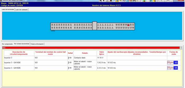

how are you. I have a failure in the 3 cylinder of a Nissan Ga16 Motor year 1995. Red spark by the distributor. Revize injector feeding and this OK, the injector tried it x separate and this ok. Apparently it has no injection pulse.
If it weren't a cable problem, would it be failure of ECU? If it were the CMP sensor failure, are you likely to only affect an injector?

Friend tries to test the injector feed in +, the ECU only handles the injector negative, to verify the cable test continuity of the injector to the computer.

The injector reaches voltage +. What I did was get the plug from the injector on the side and connect it to the one who fails and began to inject. Therefore it is x pulse failure to the injector. Tomorrow I will revise continuity of the injector to the ECU. I think that if everything was ok, it would only be Falla in Ecu.

Well, the problem was presented after making motor adjustment. The 3 injector does not towards the injection medium injector continuity to ECU, and there was no. Problem: Cable that sends land to the cut injector. I repair it and the injector is now doing the injection.
