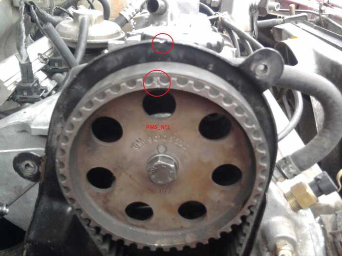

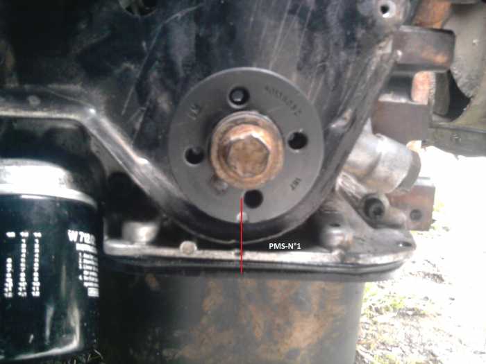

Year 1997 Multipunto with TSZ-I ignition system. Revize the brands of the distribution strap and this OK. both in the camshaft and in the crankshaft. Before I had bouncing and taque taps, but not towards this failure. It was repaired and began with this.
