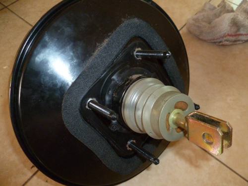

I have a problem with the peugeot 306 1.8 gasoline servo, (it does not have the Blessed APR system, nor the bosh anti -lock), it lost air through the pedal but does not lose any liquid, and stops well, but when you release the brake pedal it releases air below the pedal, what can it be? Do you have a pressure and brakes, why does it lose the air below? If the diaphragm of the servo was broken, would not official ???? Thanks for the attention! greetings!!!!!!
12 years 7 months before #41144 by manual-mecanica
Manual-Mecanica Response SERVO brake theme
Hello, the problem is not serious in terms of braking efficacy, this causes it that in the served part it carries a neck where the envelope that strengthens the pedal slides. 1- I could change the servo
2-A stamp could be adapted (mark the position of the Servo coupling)
3- Review and regulate the brakes (low brakes is one of the causes that this seal is damaged)
