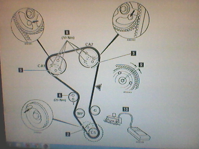

I need the Peugeot Time Band Synchrony Diagray 306 2.0L 16 Valves
12 years 4 months before #41045 by manual-mecanica

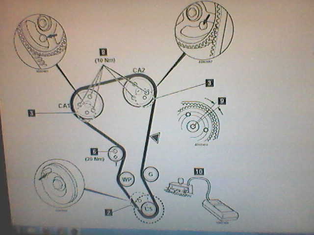

Greetings This diagram is a 306 motor xu 16v 2.0 year 2001. I hope it serves you
12 years 4 months before #41047 by manual-mecanica
12 years 4 months before #41057 by manual-mecanica
Do not be surprised if when you take it to point you realize that the 4 pistons are in the middle and the valves are left to the lot, because this is how this engine is not that the diagram is bad.
