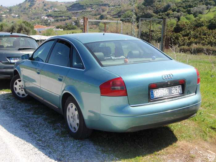

Greetings foros, I have an A6 of 98 2.5 TDI of 150 hp 6 speeds and that is that while it goes up only of turns and low (accelerates only) and even sometimes when starting with the stop engine, 1,100 rpm is triggered and after a few minutes it lowers 800.
