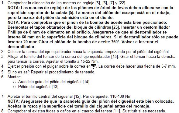

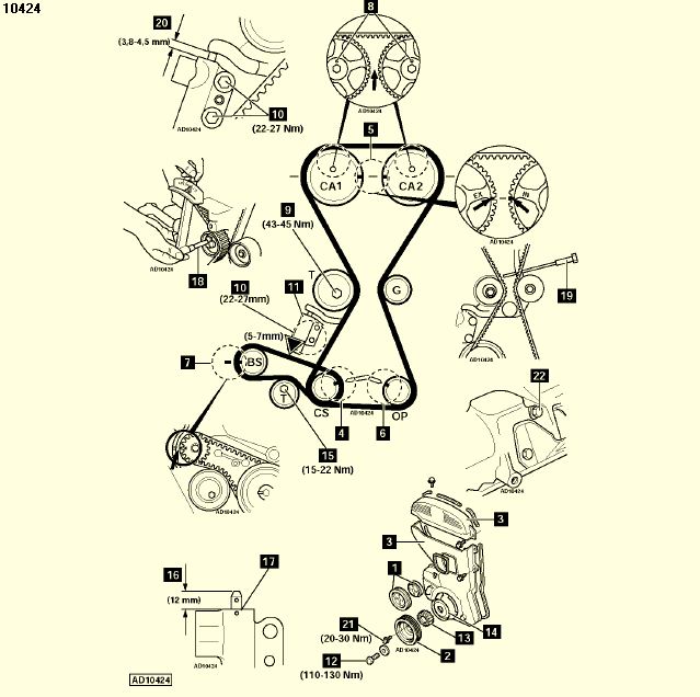

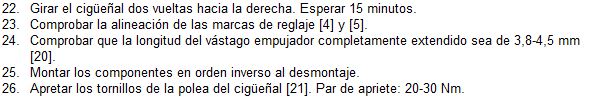

Hello friend I have a Hyundai Elantra year 93 1.6 Double Crue The Things is that I change the cylinder head packing and when putting the crankshaft piñon mark according to the manufacturer, the piston number 1 does not have up the question is the next one is the next one I guided me by the manufacturer brand of the piñon of the crankshaft and the piston a little further down or put the piston up and a new mark on the crankshaft.Aqui photos to see if it understands me.

Hit it with the factory marks, you cannot run because they have chaveteros not everything sees them with the pistons in PMS Peugeot does it with the 4 in the middle.
12 years 8 months before #40566 by manual-mecanica
Manual-Mecanica response on the problem with Hyundai Elantra
I forgot before starting the engine by hand so you will make sure that it does not come
