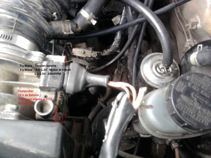

Hello Maurocont, with respect to the TPS, a calibration with closed butterfly, connected tps and open contact. The higher voltage you get better engine response, but the combination economy decreases. On the contrary to less voltage better economy I leave it at 0.45v. This same Nissan Ga16de threw the benzine, in this case the MAF had been disoldening a pin that connects the sensor plug making it fail, it welds it, and ready. The strange thing that ECU did not throw any fault. I send you some photos.

Thank you very much for your answer, I will review the unused cable, although I think that on that side everything is ok, since I have been making measurements and experiments. I think that my problem is in the alternative MAF that we buy, since it delivers about 11.3v in idle. Thanks for the photo you sent me.
