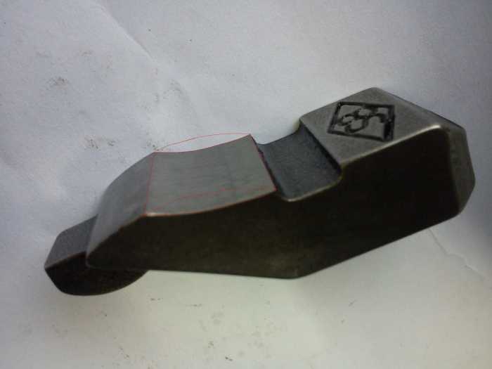

The Isuzu 2.2L vehicle from 2004 arrived with a sound of propellants, the camshand of the rockers and the propellants were changed; When a week passes, the sound begins as a result we have a totally worn balance and its respective cam. What could cause this damage?; YEAH; The material is good the oil pump in with the vehicle in idle has 40 psi and 4000 rpm rises to 60 psi of pressure ...

Perhaps the lubrication hole of that balance and cam is obstructed is the only thing that could produce that wear focused only on that cam and value the wear has to be due to lack of lubrication
