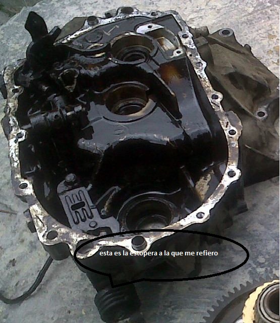

Good evening, I need to change the steope of the change selector of a Manual Mazda Allegro 1.6, the only way that is seen is disarming the box what does not seem logical, will it be that there is a way of turning and taking out the selector ???

Friend when I say Esperapo referred to the oil seal, which is in the speed selector
In the image you see the dust guard and the oil seal that I want to replace but that is not my box is a reference since mine is armed with a small leakage for the indicated place

Ok the selector overalls on the occasion only just disassemble the upper part without taking out the box but you have to be careful that nothing is disassembled from the selector Hasia inside and remembers the position in which you took it out.
