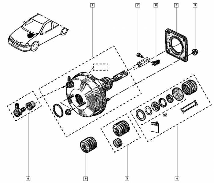

Hi: Look at the brake pump serve (which looks like a flying plate), a vacuum retention valve is connected (it is similar to a headset). This valve is usually economic, and when it breaks, it usually emits a whistle, which is nothing more than empty that escapes by this broken valve.
The number of this piece is 7701206228.

If you listen to it inside the cabin then they are the cellos of Servo brake, in some cases there are brake houses that repair them but in others it only remains to buy it and change it for a new one, but that it is the fault of the servo is the fault of the servo.
