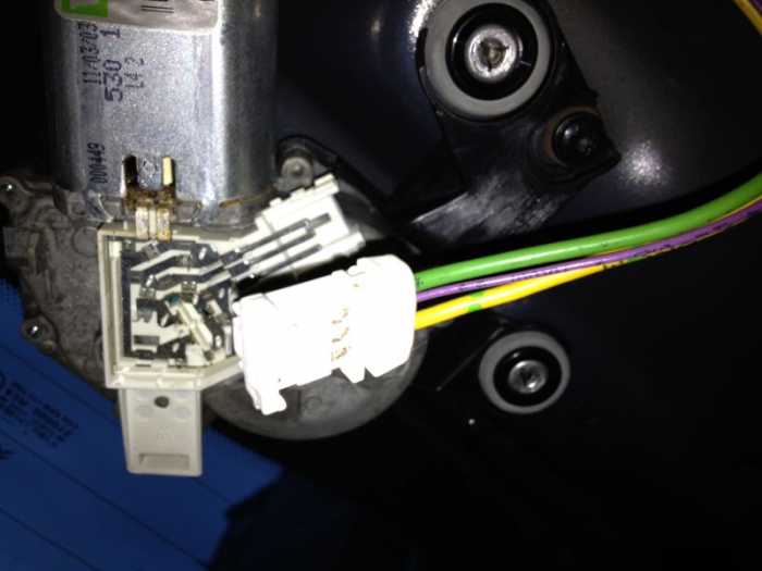

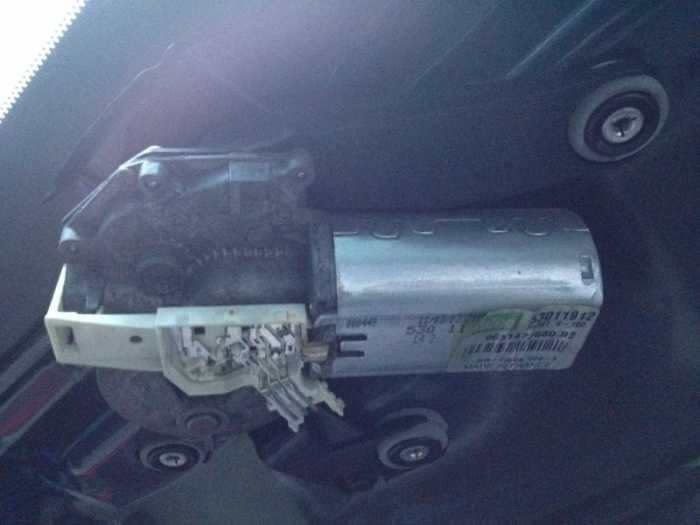

I have disassembled the lid where the clean engine goes and there is something that does not fit me.
Three cables arrive at the connector: thick green, finer and gross yellow.
Between green and purple 12v.
Between green and yellow 0v.
Between purple and yellow 12v.
I active the clean (I hear in the fuse box the rel) and there nothing happens, I explain, I understand that I would have to have some kind of passage in the contacts, when it was played by the movement, and I always have the same tension in the same terminals.
The most curious thing is that this test is done without the connector on, since, with the connector on I have no 12V tension where I had it loose (it is crazy). Loose 12v, connected 0V.
I don't know if you will see the photos I am trying to send
greetings and thanks
