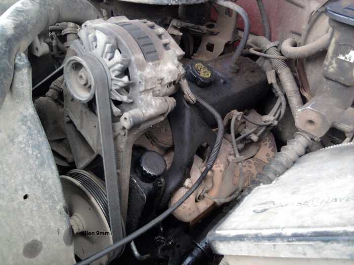

I have a leak in the hydraulic address pump of a GM V6 4.3L Chevy or Work Truck.
To remove it, I must remove the pulley wheel, but it carries a 9mm Allen, too tight, will there be any way to get it not to be a hammer blow ???
I attach the photo.

Hydraulic or pneumatic gun, but in reality it is very difficult to take it out, I disassemble the entire tracera, since it is like a complete plaque and finishes it outside and yet it was a hell, squeeze the pulley with the bank turning and a lot of passance and heat hahahahahahahaha

I planned to take out the support that houses the pump and alternator
but the support carries bolts behind the pump, so it is necessary to get this 1, but before the pulley wheel. Patience I have arta, as it shows that it is American, haha. When did you take the pulley the Allen bolt that carries in the center, rotates the bolt or pulley ???

If the bolt turns but I remember correctly is left thread.

It indeed has left thread, they told me that it hot it a little, then locks the pulley and try to get it out. That is what they told me in a ST. Let's see what happens.
(Finding TB there is an extractor, but expensive $ 50mil)
