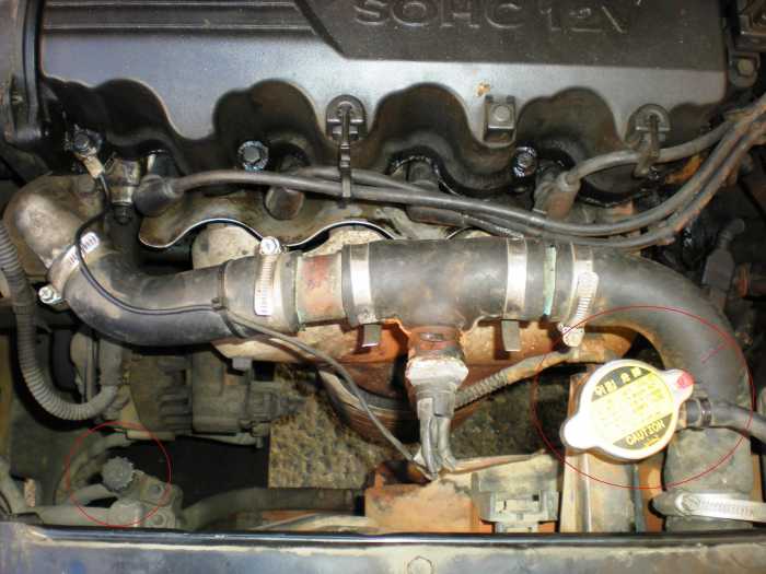

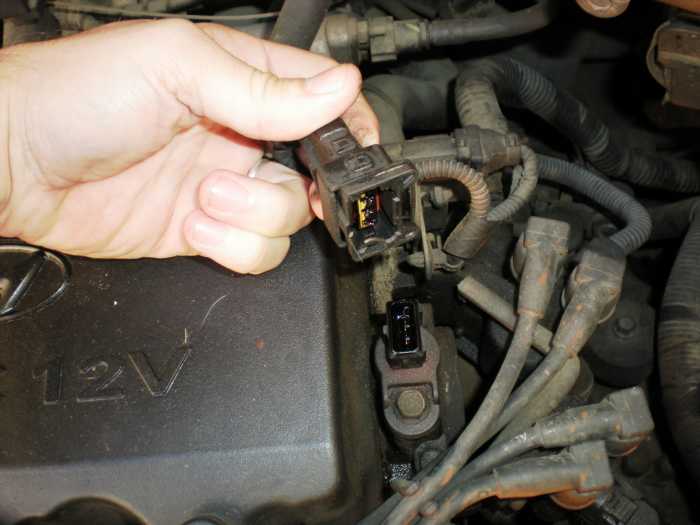

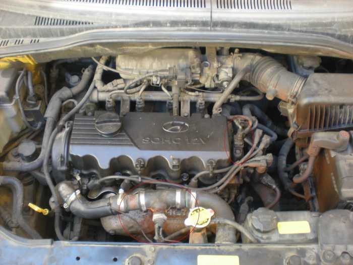

Thank you very much for the answer Gordillen, I send some photos of my motor zone to see if you find any problem and to see the state in which it is and what the mechanics did to me.
In the first we see the electric thermostat that they put me and with a circle above what I think is the original thermostat, whose connector I have realized that it is full of oil inside, it is seen in the following image.
Then we have the radiator cap that one of the mechanics told me for a long time to leave him for the brand he made to me in the tube, now he is erased but is where he is placed. Another thing I remember that he will do 2 years without realizing the plug that puts h that I have put a circle, I have realized that this goes to the radiator has something to do with why the mechanic never told me any of this?
Finally you can see the entire ocher in the motor area.

That such a friend
to my opinion is oxide, you must check water and thermostat pump and something very
important Frio The car fill the water edge and turn the car without the radiator plug, if the water does not skip the radiator and do not leave air bubbles, it indicates that there is no damage in the engine, otherwise you will have to check the engine head (button)

The most likely by the symptoms is that the blanket packaging has been damaged or crooked the same so the healthiest is to remove it to rectify it and check that it has not cracked and change the packaging and thermostat washing the radiator and change the oil and with that the problem would also be prudent
