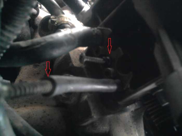

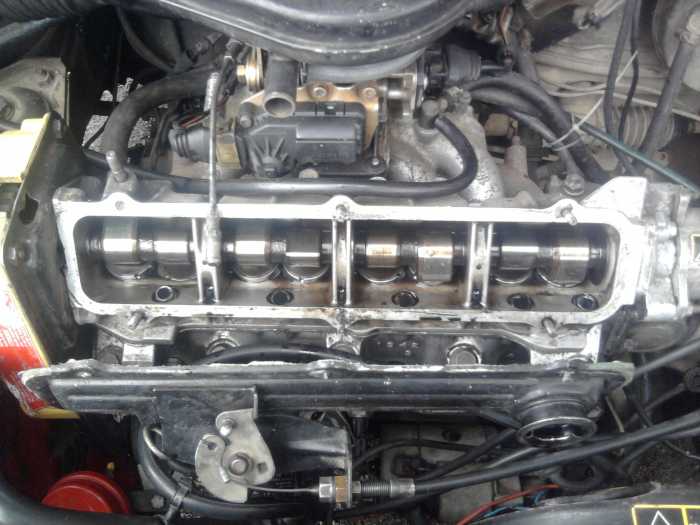

I tell you, it has taque sounds, checking there are slacks. Check the coil. The primary resistance gave me a value 0.1 OHMS (Autodata 0.4-0.5Ohms) Resistance 2 is within the ranges. Now what you tell me about the air flow mass meter. As much as eh sought, I can't find something similar, now the butterfly body is a suppressed manguerite with a screw. Is that? Where that meter should be found. I attach some photos

It is the monkey point so it is not so terrible to clean the body of admission or tbi as you call and clean the monoainctor for better results and tests to walk much better.

Check sensors and calibration, change of spark plugs, cables, oil, oil filter, benzine and air. Body cleaning admission, and injector. Adjust valve slacks, adjust tuning and everything perfect. Pretty conforms to be the 1 time I see a Fiorino. And thanks to Kikemec for his help.
