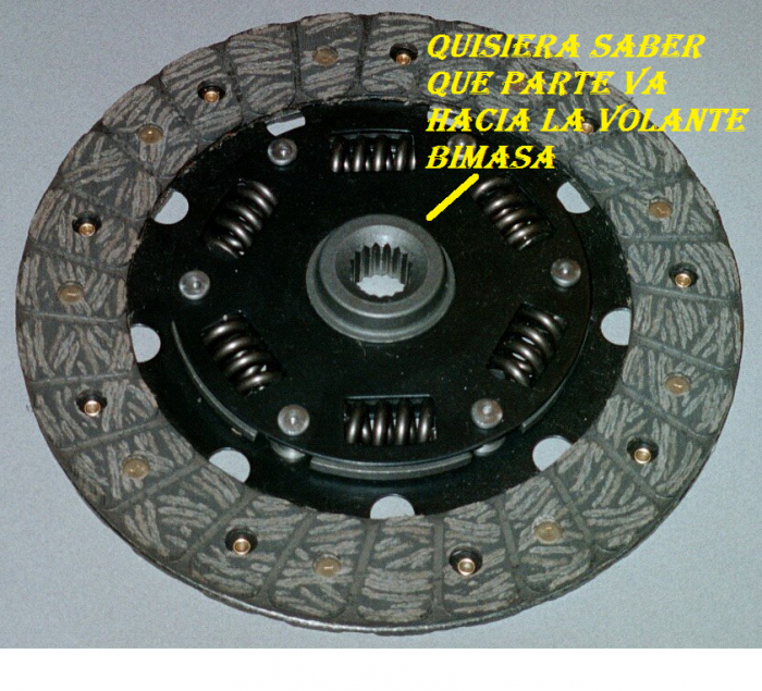

Good friends from the forum if Alqguien could help me as is the correct position of mounting the clutch disc in a bima wheel of a Captive Chevrolet Motor Le511 year 2011 ... I would like to know what is the part of the disc that goes to the flywheel Bimasa because there is a part of the disc that stands out of the striated hole where the entrance axis of the transmission box enters .. :(

Jozh, the part of the striatum that stands out more goes to the clutch mace and if you put it to the setlings, the part of the springs brushes in the steering wheel does not clum up in conditions because it brushes in the steering wheel.
