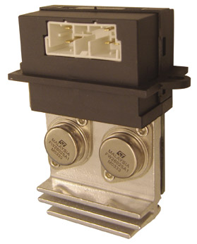

Thank you Gordillen for your quick response, the reason for thinking about the filter is because the car has AC and the Fair Na fan gives more air flow than the second scratch of the 10 that has the fan command, if you have any idea of ​​what I can do ...
thousand thanks again, 1 greeting from Tarragona, Spain
13 years 3 months before #36403 by manual-mecanica
Manual-Mecanica Response on the Re: Clio Campus 1.2 filter of 97
It is very likely, Luis, that the problem then lies in the electronic air conditioning control control. When it breaks, it causes (among others), the problem you have now.
This piece is found in the ventilation housing, so you will need a specialist to replace it.
In the attachment I send you an image of the piece (at least, of the American version). I hope you can see it.

Thanks Gordillen for the attached image and the answers, they have served me a lot;) I receive a cordial greeting!
