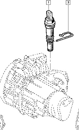

Adrian, I have the same car, and mine works with a speed sensor that is mounted on the box (are you sure you don't have it?). It is very common for this sensor to break and bring problems like the one you have. The number of the piece is 7700418919 (No. Renault)
