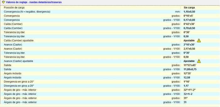

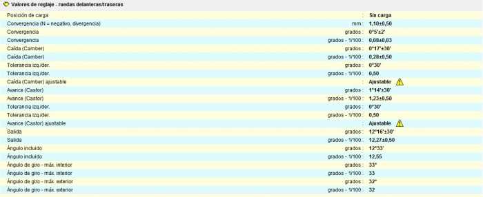

Hello, I tell you that I have a rear differential of Toyota Hilx (rigid) with elastic of which was model 98 if I'm not mistaken. It was the model that brought 2.8l engine. I have this axis installed in another truck but when I see it I notice that I have the rear wheels with a positive Comba and a pronounced convergence.
Someone could pass me the Comba data and convergence of the rear axle of this model or even if it is the Hilux or 4 Runner model ?????

I calculate that I could serve the 2.5Diel 4WD data and 3.0l ...
13 years 4 months before #35798 by manual-mecanica
Manual-Mecanica Response on the Rear Toyota Hilux rear axle
These are the data:
2.5
3.0
