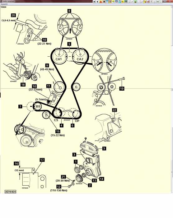

In Autodata (I have version 3.24) search for year 96 Hyundai Sonata engine 2.0 16v, it's the same engine, engine type G4-P.
13 years 6 months before - 13 years 6 months before #35334 by manual-mecanica
Manual-mechanics' response on the topic Re: Timing of the timing belt on a Hyundai Santamo 2.0
ATTACHING FILE:
File name: Distribution.zip
File Size: 399.36 KB
So you can download the setup.
Here is the image
