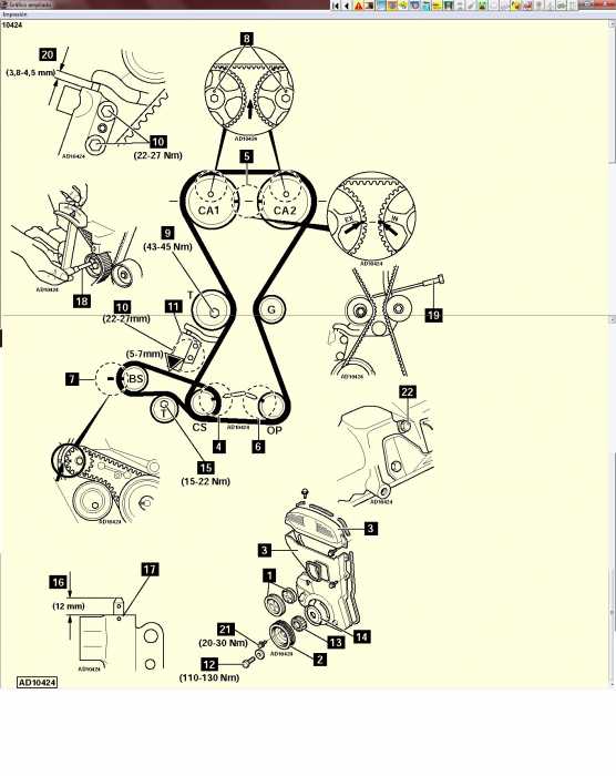

I need if they could break the set -up Huinday Samtamo 2.0 2002
13 years 4 months before #35317 by manual-mecanica
Manual-Mecanica Response on the Re: Distribution Distribution Huinday Santamo
The distribution has marks, the two polish pulleys have two marks each, they face in the middle and the other is lying on the edge of the cylinder head or in 90 degrees according to the engine, the pineapple of the crankshaft has a notch that faces a relief arrow that is stamped in the cylinders block and the short strap also has stamped arrow marks are easy to see and make the draft.
13 years 4 months before #35335 by manual-mecanica
Here are the data:
