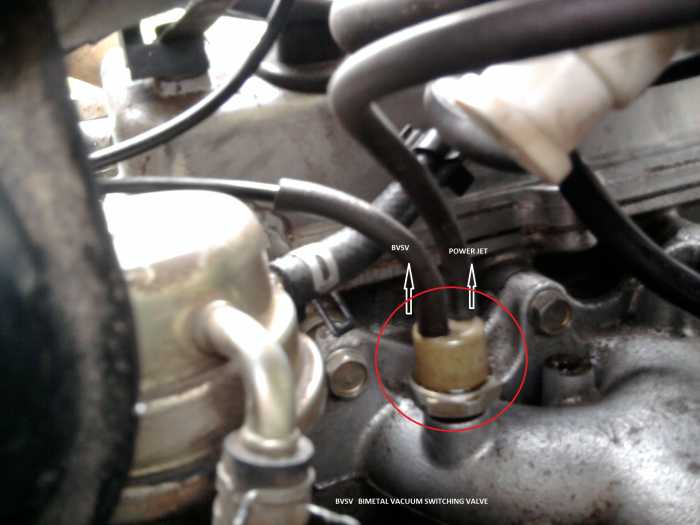

Greetings to everything x here.
Someone knows the name and what is this piece for
In a Daihatsu Charade G102 Motor HC 1.3
I need to change it since it has oil leakage

The technical name I do not remember but it is an empty supplier if I remember correctly one of those hoses goes to the pneumatic advance of the distributor or not?

It is an emptiness taking) of there its complement to which it provides empty

Thank you Kikemec and four X your answers both successful, this piece is throwing me too much oil, and for not changing it in time I damage the regulatory box of the alternator. Will it be normal to boat so much oil?
