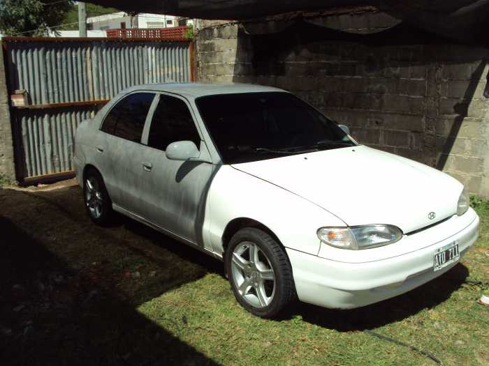

:( Hello everyone on the forum, I have a problem with the power steering pump on my Accent GLS. I replaced the bearing because it was making a lot of noise, and now the pump doesn't have enough pressure, and the steering is extremely stiff. Could someone lend me a hand? I need to know what the problem might be. Thanks.
