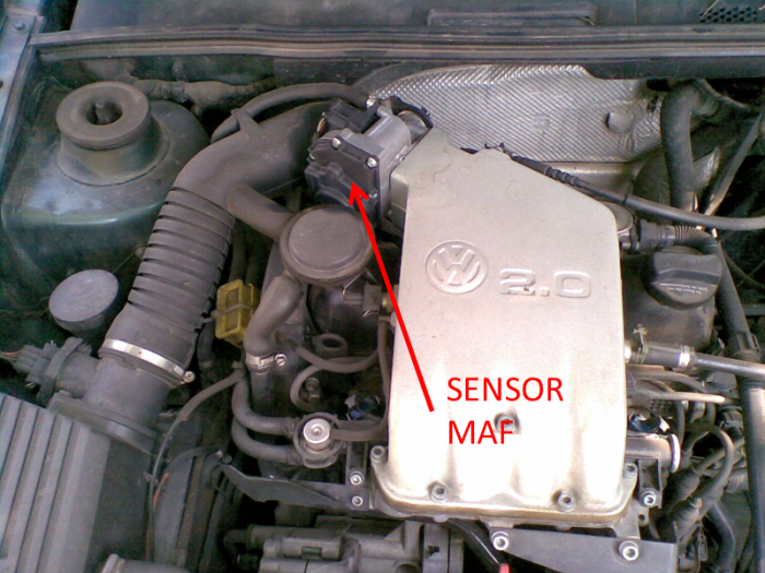

Thank you very much to Antonio Campos and Kikemec for their tips the question that I already checked and my car does not bring the MAF sensor that is like a cylinder I will take a photo and upload it to the forum to be safer in fact the car no longer fails is stable the only problem is stable is when I turn on the climate then it is when the revolutions begins to vary. thank you
14 years 4 days before #27700 by manual-mecanica
Manual-Mecanica Answer on the Re: Jetta97 MAF sensor
That again here I take photos that is supposedly the MAF sensor of my car as my car told them is an American Jetta 97 once tube the same problem and they cleaned this piece that I show you in the image according to some friends tells me that this is the maf sensor the truth looks for the display of this piece because I do not want to irrigate it or that at the moment they uncover the foot. I appreciate your help.
[Attachment: 1] C: \ Fakepath \ MAF Sensor Jetta 97.png [/Attachment]
