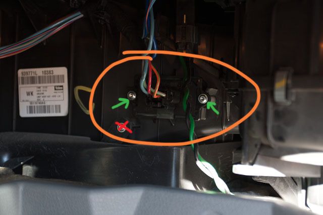

I do not know how to fix my weather since only speed 4 works next to this the radius low the volume or interferes when the brake floor --- is a 4x4 1997 motor 4.0 engine ---

Good compa, ok, you are going to check the resistance of the Blower first, it is inserted in the same room where the blower or fanfish of the air conditioner is located, it has two screws is rectangularly and is stuck to the side of the fan at the feet of the companion's side. The resistance has a five -line connector of which four are negative inputs and one is the return to the Blower. Each of these four inputs responds to a point of the climatizer switch. If the four cables respond to the four signals then the resistance is burned, if there are no signs that react to the switch point, then the switch is scrubbing. With the radius or idea, you may have some bound line linked.

:lol: Thank you very much for your prompt response, effectively looking for you where you told me and although it is a bit different from that of the photo if I found it, within this one is a molten cable, check resistance and it is working well, I will weld the cable and comment on the result ...
Many thank you ....
