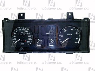

Good night, engine lovers, I wanted to ask if anyone knows if in my Clio 1.9 D campus I can put a cup that marks temperature and revolutions thanks

Yes, you can get an instrumental picture like the one in the attachment. Nro Original Renault: 7702227135. This has a tachy meter, fuel level, motor temperature marker, and speedometer.

They told me that for the temperature to mark the sensor the car and so much the account revolutions, if I find a picture with that ready reference, right? Thank you so much

The temperature sensor Vá connected to the vehicle cylinder cover. If you do not have it installed, it is applied, and ready, resolved.
With respect to the tachymeter, I think that in that vehicle model the alternator signal was taken; Anyway, any electrician could help you with the installation.
