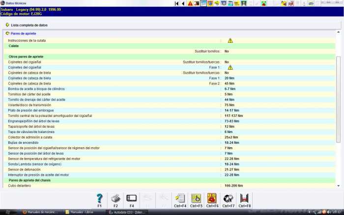

I have an Impreza 96 and I was repairing the engine but I don't know the bulls of the rod
13 years 9 months before #25218 by manual-mecanica
Manual-Mecanica Response on the Re: Subaru Impreza 96
Friend attached the image, I beg you if I correspond to the motor code of your sub -Uru to eliminate any type of error.
