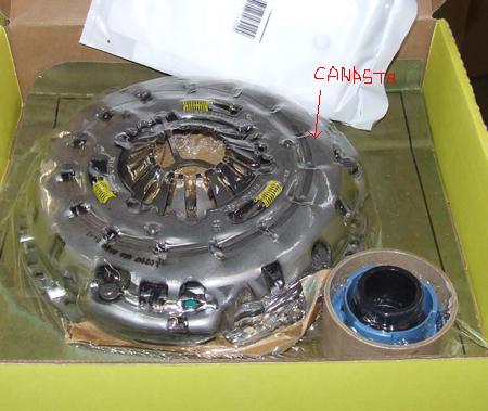

Hello everyone, with a consultation for the knowledgeable ones of the Ford Ranger, it turns out that I am changing the clutch to a Ranger 96, and when buying the clutch kit, they told me that the clutch basket is graceful, my question is, how do you graduate? Since and changed from other cars and it is only taken off, the steering wheel is rectified and ready, but these rangers if I did not know how to graduate the baskets, if someone can throw a little hand with some info, I will appreciate it very much since I have the truck unarmed and I have to put together but I do not have it for that doubt. Thank you very much to all and success.

The truth that I have never heard that they graduate have changed many of Ford Ranger and I have never regulated anything, and they work in the rather any problem, and so they are never regulated, they are overlooked behind the wheel and now, just look that it is not too flat.
