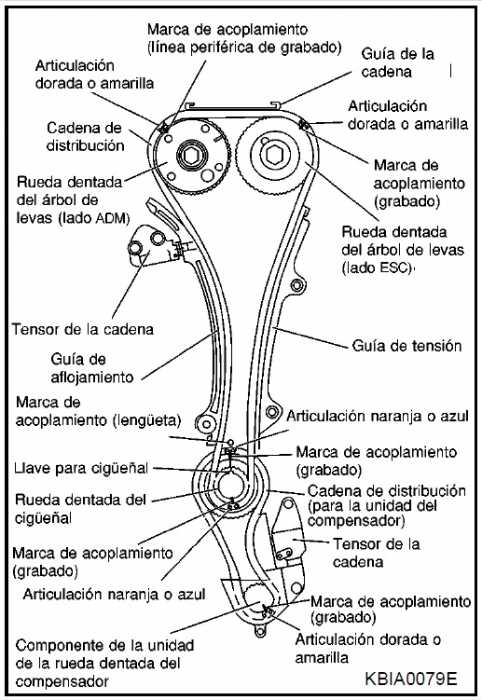

Good night to all, someone can help me give me the maarcas of the distribution of a Nissan Xtrail 2003
13 years 11 months before #23492 by manual-mecanica
Manual-Mecanica Response on the Re: Distribution brands
Here is friend ... I hope to get on time and have helped you
