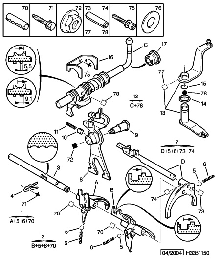

14 years 1 month before #21317 by manual-mecanica
Manual-Mecanica Answer on the Re: Problem with Citroen ZX 1.9 Diesel Turbo

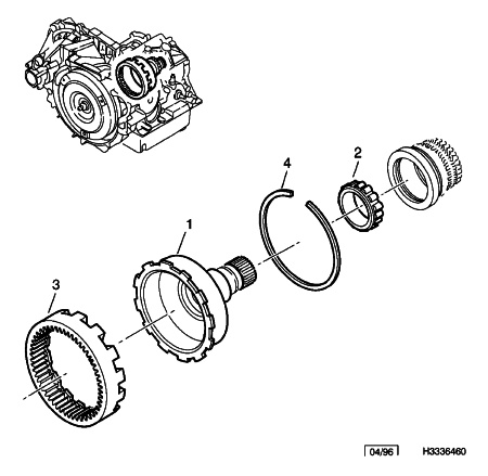

Hello, you will see how Osomarius offers you, you have to check the orchone that mounts in the selectors, wears the balls and docks you can try previously to harden them before disassembling. It is number 5 and 6 of the figure below completely
